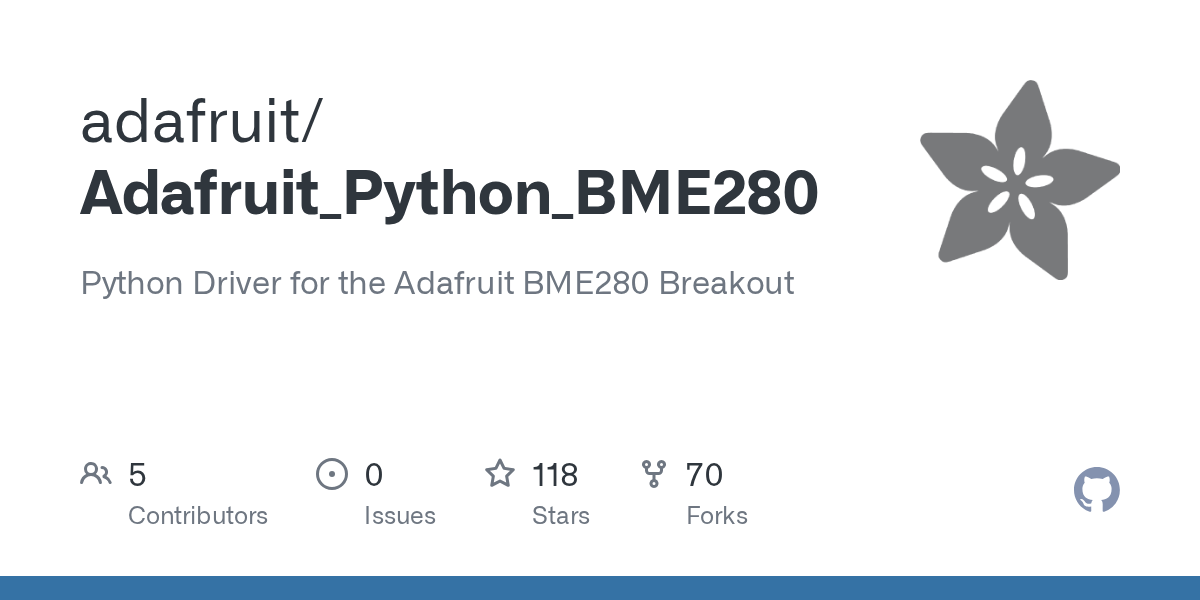

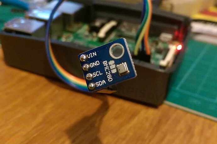

Since there’s no hurry, I’d appreciate it if you could test Raspberry Pi with the code and a board you know works when you get a chance. If you get the same results, then it’s a bad unit, otherwise something is wrong with the library or the board isn’t compatible with RPi in some way.
To start, you could try the Python scripts from the two links below, that should be faster. They give me the same results, but with slightly lower pressure (about 200 hPa lower, I haven’t read the math they do, but the temp and humidity are the same).
I forgot to mention that I can see the board on the I2C interface using the i2cdetect -y 1 command at address 0x76 and there are no problems with communication.
