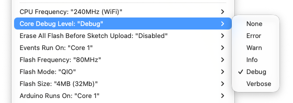

Can you please set Core Debug Level to Debug like the image below and send us the logs. You can find it under Tools:
Also, you could try reseating the flex cable of the display, maybe it came loose.
