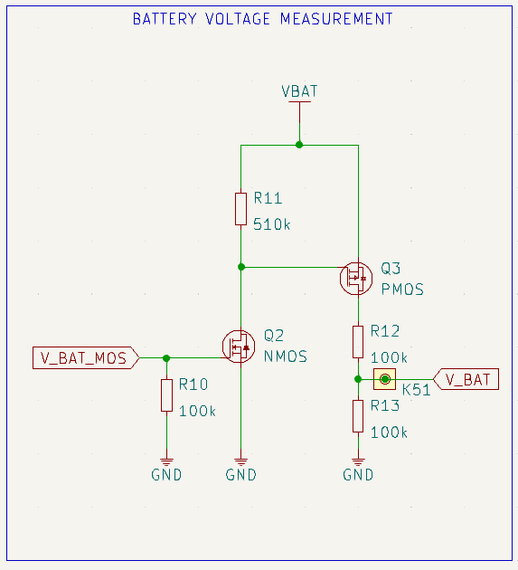

Do you have a recommended circuit which wouldn’t compromise the low sleep power consumption?
Hello @mail,
Please find attached a schematic of our proven battery voltage measurement circuit.
The V_BAT_MOS label connects to any GPIO on your controller. Driving this output HIGH enables the measurement circuit.
The V_BAT label is used to read the battery voltage and should be connected to an ADC pin on your microcontroller.
If anything is unclear or you need any further assistance, please don’t hesitate to get in touch.
