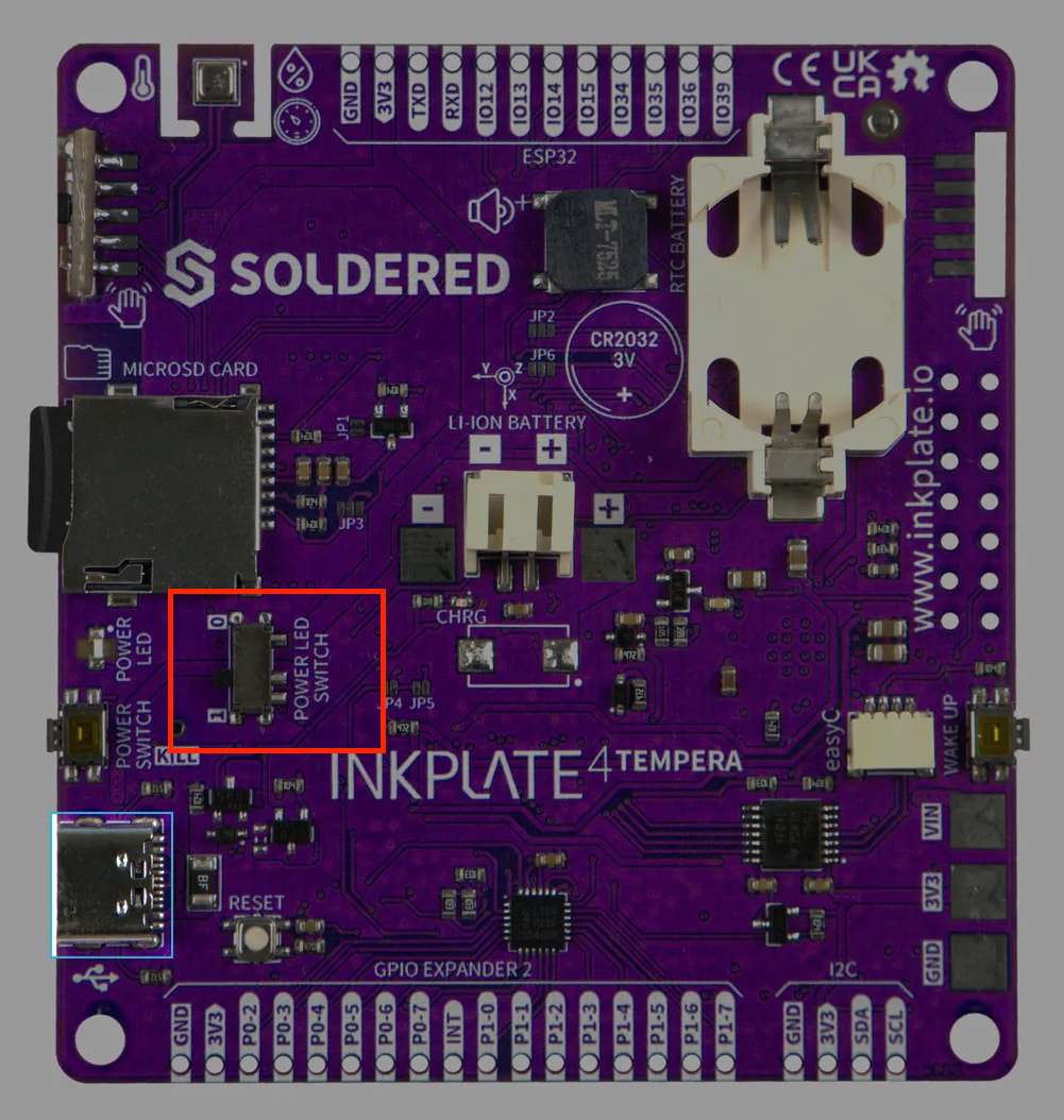

Hi @f_m_may
Pressing the I/O buttons turns the Inkplate completely off.
There is a Power LED switch on the PCB itself which you can use to turn just the LED off. You will have to disassemble the device to get to it though. It’s circled red in the picture below.
