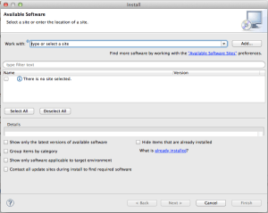

Have you tried with older IDE versions, for example: https://www.arduino.cc/download_handler.php?f=/arduino-1.6.8-windows.zip
There are plenty of alternatives to Arduino IDE. Eclipse is definitely higher quality:
Original message (Croatian)
Jesi probao sa starijim verzijama IDE-a, npr: https://www.arduino.cc/download_handler.php?f=/arduino-1.6.8-windows.zip
Postoji dosta alternativa za Arduino IDE, eclipse je sigurno kvalitetniji:
Arduino Eclipse IDE and Plugin V2.2 installation – Trippy Lighting
