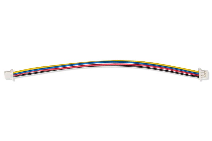

To connect them to the Dasduino CONNECT, you’ll only need an easyC cable:

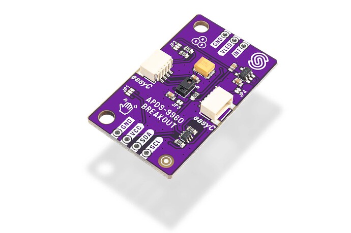

APDS9960 gesture sensor (detects hand gestures in various directions above the sensor)

If you add any of these sensors, make sure to also get an easyC cable for connection:

APDS9960 senzor gesti (detektira mahanje u raznim smjerovima iznad senzora)
APDS-9960 Gesture, Proximity, & Color Sensor for Arduino – Soldered Electronics
