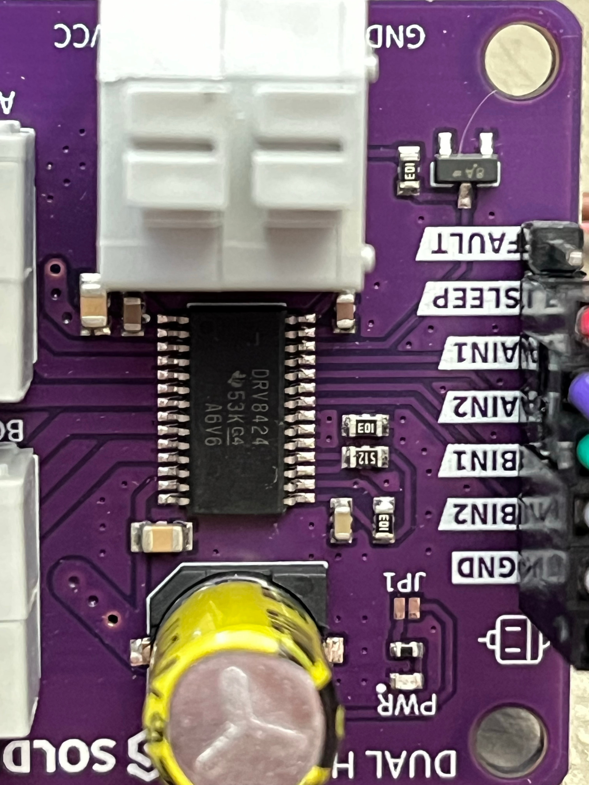

I have purchased two eval boards and for both the outputs are not behaving like the table on page 17 in the datasheet is showing.
I have tested a lot with different combinations for the inputs etc. and it looks like the board is in kind of a stepper-mode. (sending the same Input combination is activating different motors)

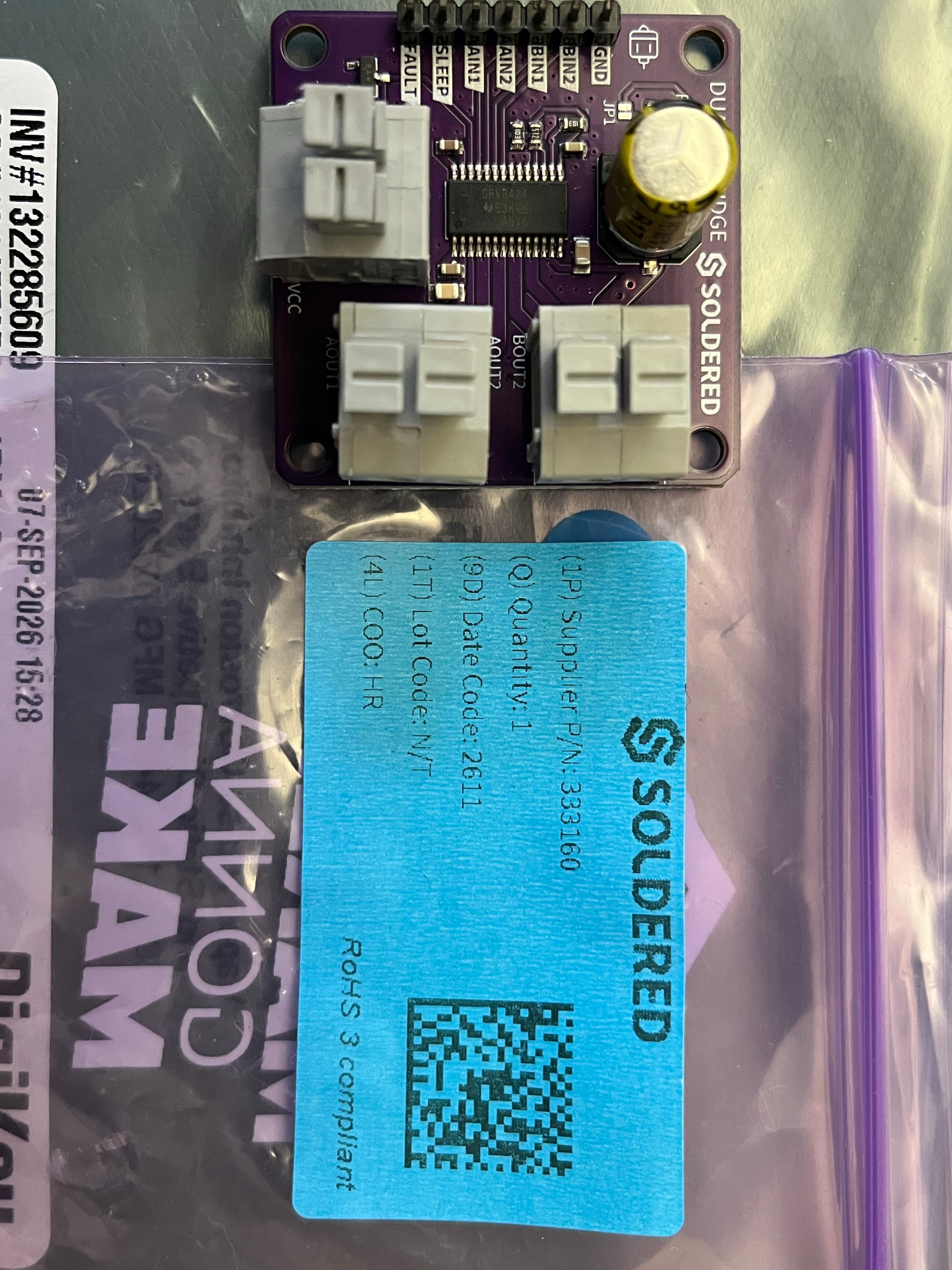

The IC on the PCBA has “DRV8424” marking without the “P” - so is it possible that my boards have the wrong version of IC equipped? (see picture)
(For reference I also purchased a DRV8424P IC and there the “P” is on the part)
Hello @michelreichert92 ,
Thank you for reaching out regarding this issue. It has come to our attention that, in this specific batch, the wrong chip was soldered onto the board. We are very sorry this has happened and you are entitled to a refund/replacement. Please reach out to us at hello@soldered.com with your order number and a link to this community thread to start the process.
