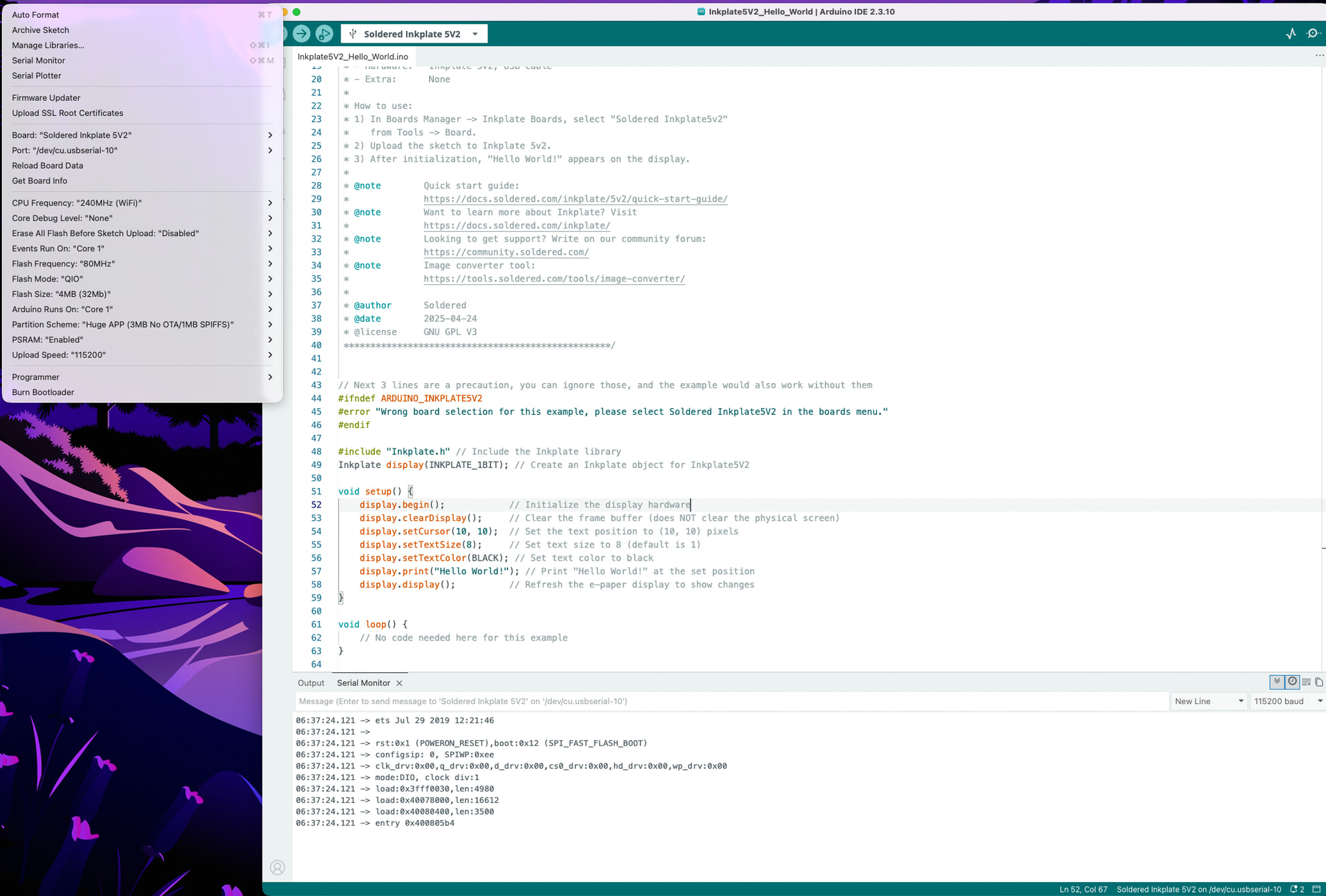

Thanks for responding, I am using a Mac (26.5.2), and I followed the quick start guide. I have tried the original cable and a known good cable that I used to flash an esp32 recently. I do get a blue light after plugging in the USB and hitting the power button. I am happy to provide any additional logs or run any diagnostic.
Have you tried installing the mentioned driver?
As i mentioned I’m on a Mac, the driver is for windows, the quick start guide also explicitly states that the driver is not needed for Mac

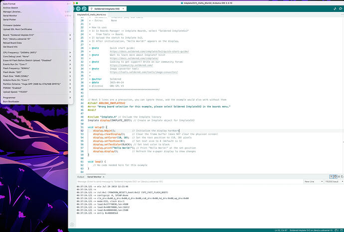

I changed the baud rate to 115200, and the upload and compile seemed to complete, however the device is stuck on a reset loop with the suggested hello world example from the quick start guide

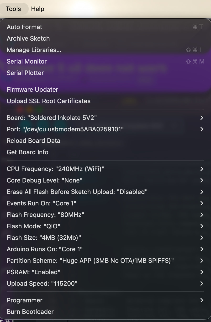

Do you have PSRAM set to Enabled under tools?
yeah
This is what I have on my end and it works fine, I’m not sure what else we could try. Can you check the code you are running and make sure it is the as mine? And make sure you are running the latest library version.
