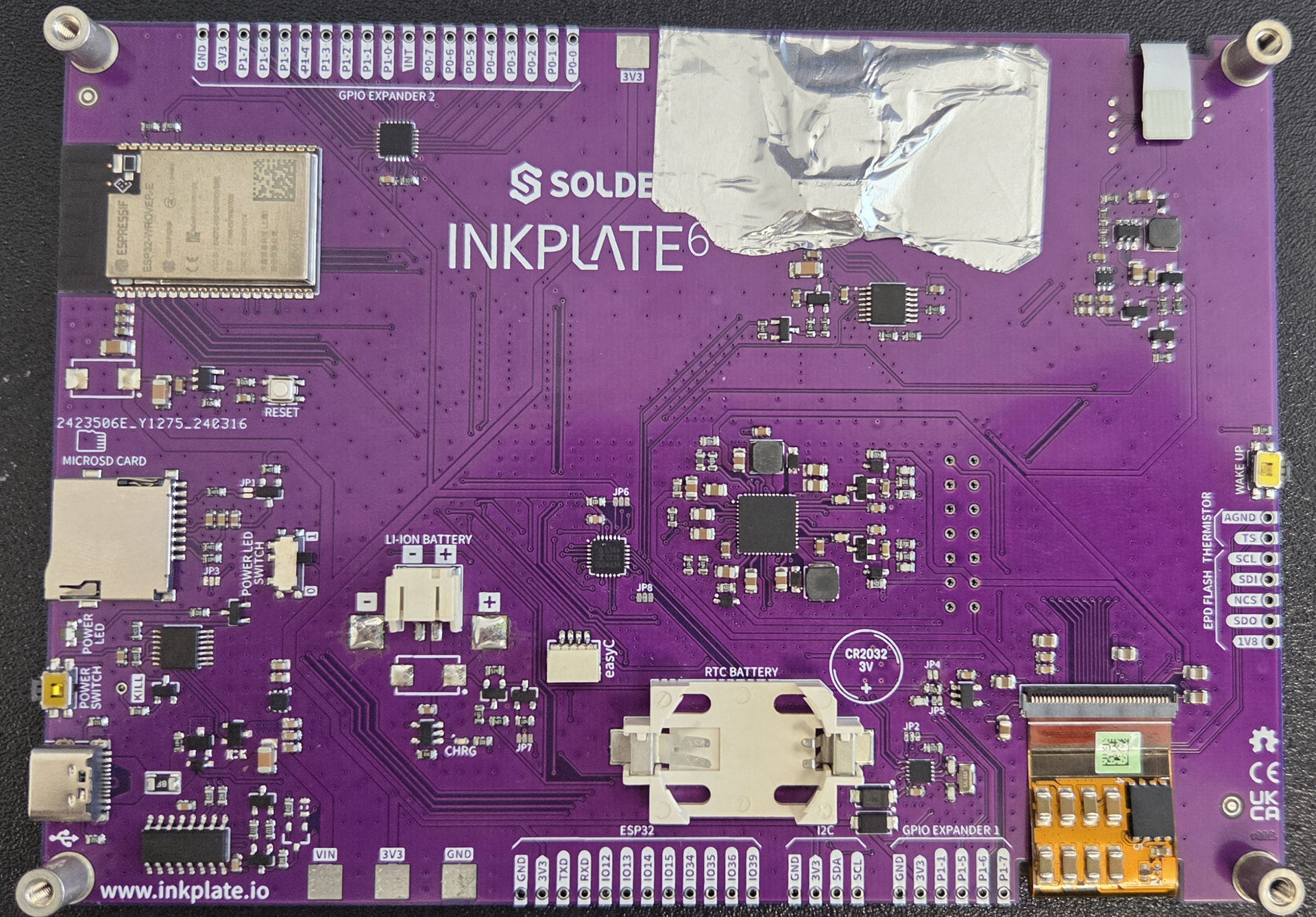

The issue you have described has been reported a few times regarding the 6FLICK, where the touchscreen gets stuck during initialization due to bed grounding of the touchscreen connector. You are able to combat this by taping an aluminum tape over the touchscreen connector as seen in the attached image:
However, if you are still under warranty, you can contact us at hello@soldered.com to start the replacement process regarding this device, just be sure to mention your order number and a quick overview of the issue (or a link to this forum thread)
