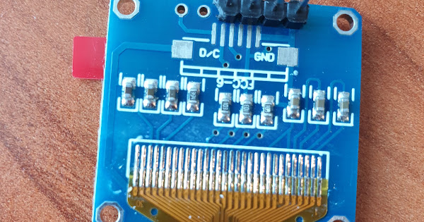

A colleague recently received a package with an OLED display from you, and I notice the board design is different from the one you had about a year ago. Here are photos of the OLED we received now:
Google Photos
I’m wondering if it’s designed exclusively for SPI communication or if I2C is also supported? I don’t see any markings on the board that would suggest how to switch between the two modes.

Customer:
The question I raised concerns exclusively this new shipment and as such I would only expect you to know the answer.

Soldered Support:
Based on the photos you provided, I would say the module you have is the I2C communication version. Depending on availability, either SPI or I2C modules were supplied.
