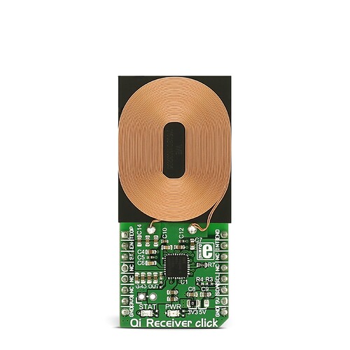

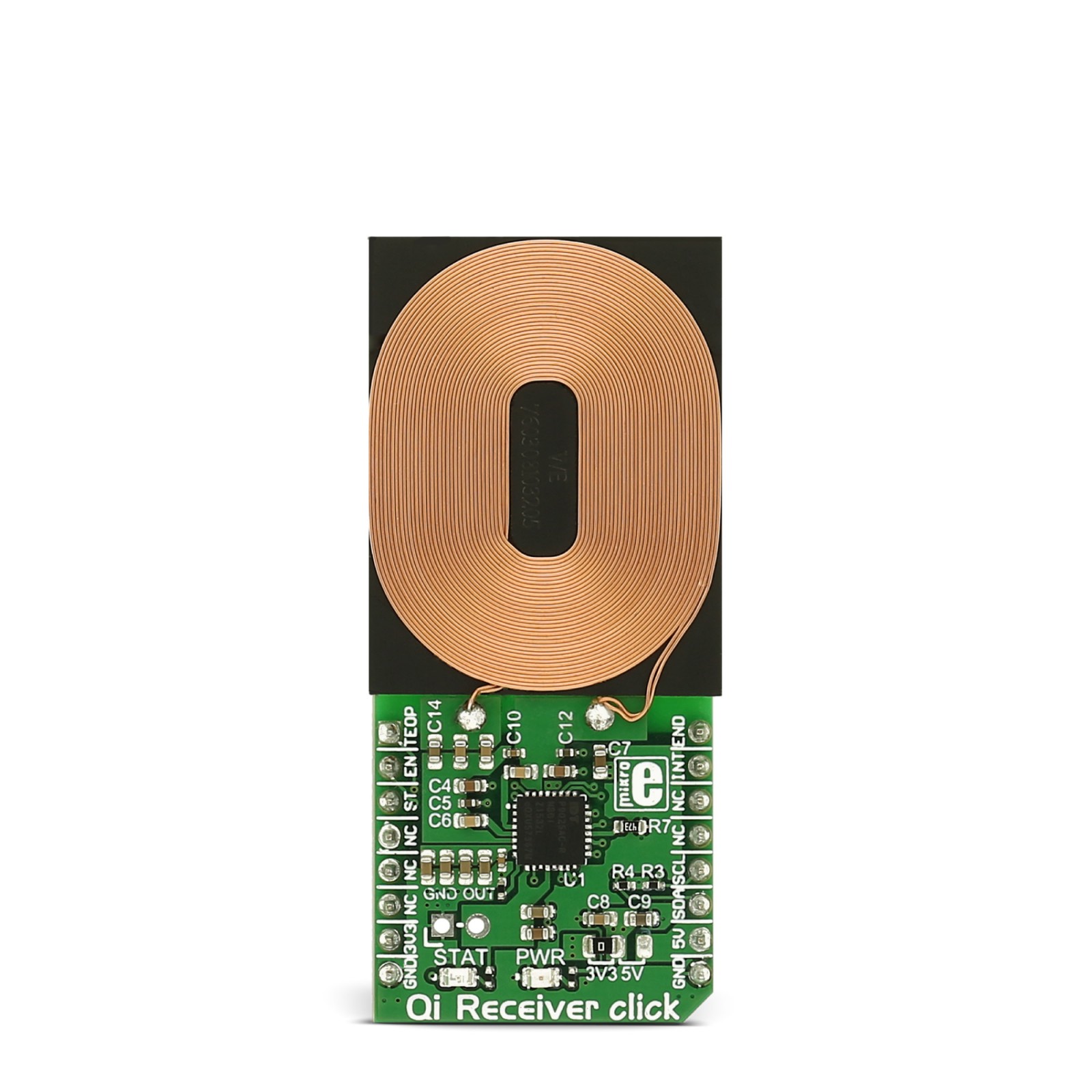

I apologize for the confusion. I use a Qi charger base station with which the Qi receiver should charge the battery. The problem occurs when the receiver is placed under the battery (glued): the charger stops charging because it detects the metal inside the battery. From what I’ve seen on other sites, the receiver’s inductors are usually glued to some substrate (panel) that affects this field. I’m sending you two links with photos:

Isprike na mozda ne razumiijevanju. Dakle, koristim QI punjač (Baznu stanicu) pomoću kojeg navedeni QI pijemnik treba puniti bateriju. Problem se naime dogaša da ukoliko prijemnik stavite ispod baterije (zalijepite), punjač prestaje puniti jer očito dektektira metal unutar baterije. Koliko sam vidio na drugim stranicama, obično su induktiviteti prijemnika zalijepljeni na neku podlogu (panel) koja djeluje na to polje. U nastavku vam šaljem dva linka sa fotografijama.
https://cdn1-shop.mikroe.com/img/product/qi-receiver-click/qi-receiver-click-thickbox_default-12x.jpg
https://cdn-shop.adafruit.com/970x728/1901-05.jpg
Hvala. Lp, [name removed]

Now it’s clear what’s happening. Unfortunately, this product doesn’t come with the material that would be glued under the antenna to ensure better charging. You can place some plastic between the antenna and the battery to separate them, because when the antenna is against the battery it affects the charger and prevents charging. It’s important that the battery and antenna are separated and not glued directly to each other.
