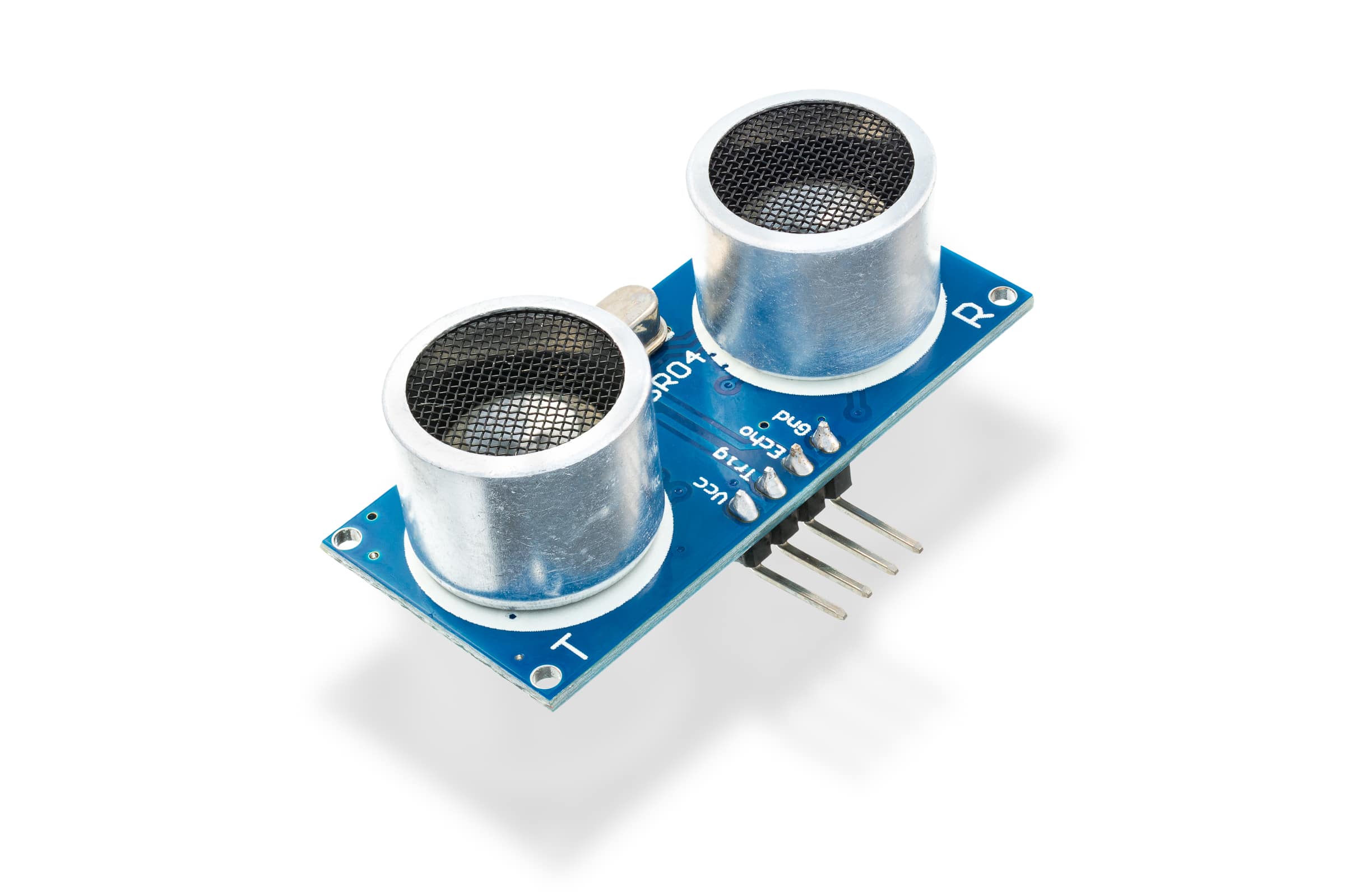

I need a sensor that can detect both metal and non-metal objects. The sensor would be placed on an object that needs to move freely in space while avoiding obstacles. Do you have such a sensor in your web shop or can you recommend one?

Check the HC-SR04 ultrasonic sensor – it’s frequently used for such applications and because of its simple operating principle it’s easy to implement in projects.
In fact, if you take the easyC version with some easyC cables, you can very easily connect several such sensors to your project:

I have your beginner’s kit with a Croduino board – can it work with this sensor in combination?

Yes, it can. Some kits actually come with this sensor included, so it’s completely compatible. The easiest approach is to take an easyC cable and connect it to the easyC version of the sensor, from the link I sent in my previous message.

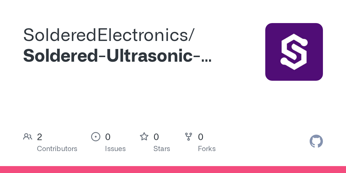

The Arduino library for that sensor is available here:
It includes examples for how to read data from the sensor and use it in your code.
