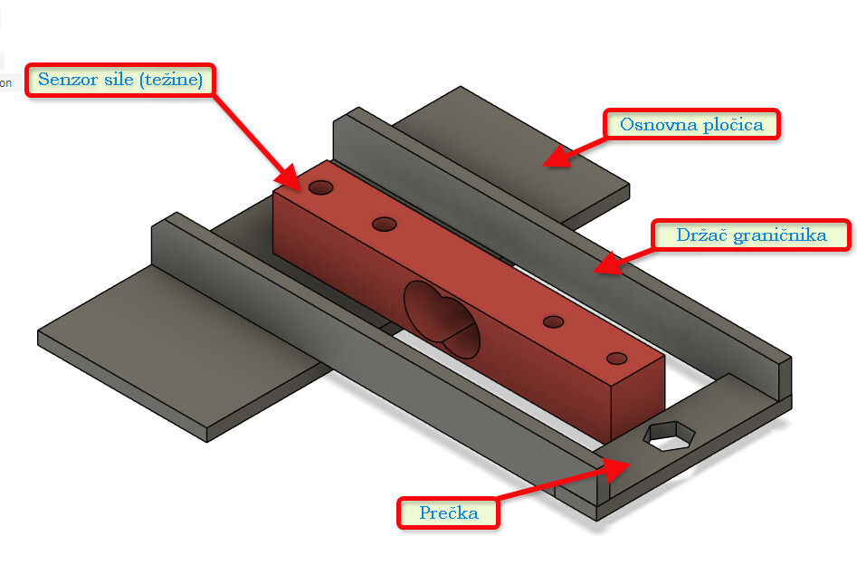

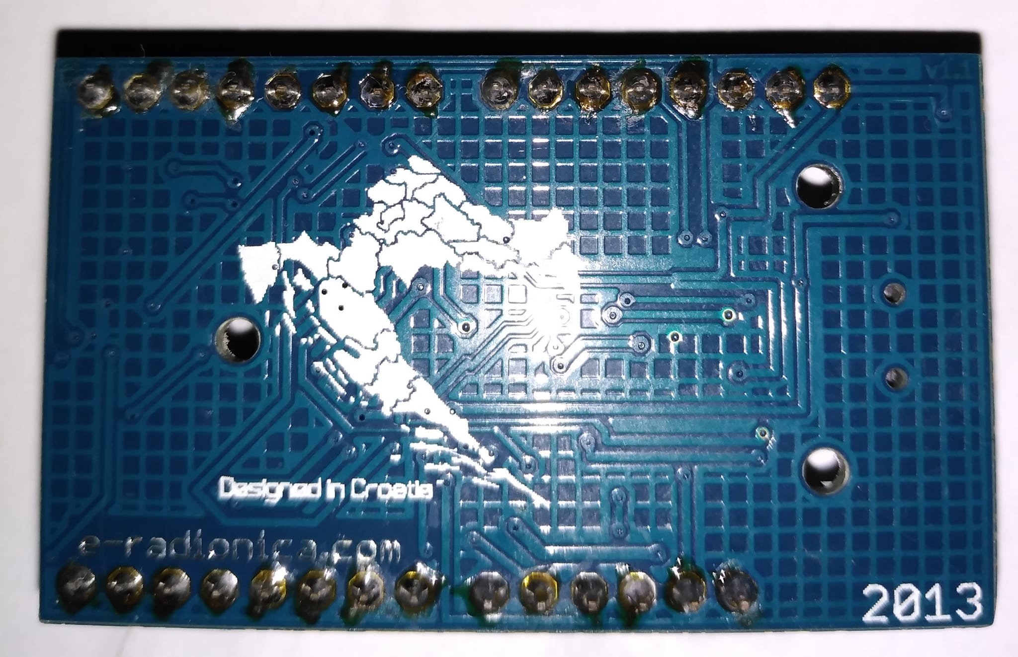

Radim Uroflow metar baziran na starijoj verziji Croduina iz 2013. godine. Senzor sile je od 2 kg. HX711 je također stara verzija. Sve komponente sam kupio prije 10 ili više godina.

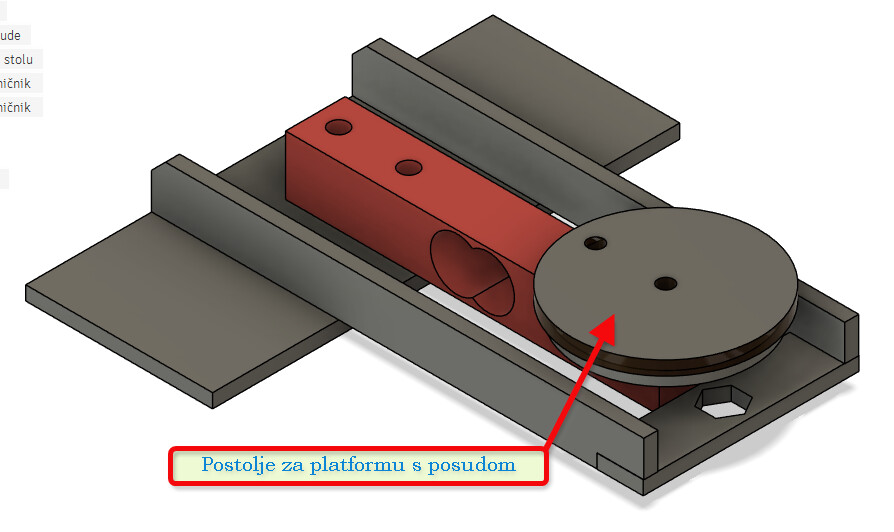

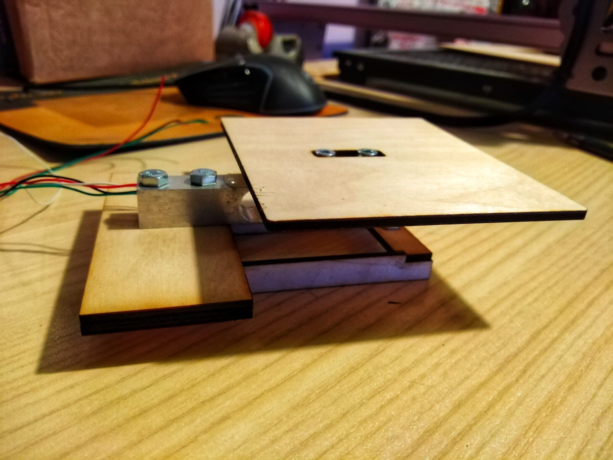

Završio sam konstrukciju koja drži senzor i posudu s vodom.
Hello everyone!
I am building a uroflowmeter based on an older version of the Croduino from 2013. The load cell has a capacity of 2 kg. The HX711 is also an older version. I purchased all the components 10 or more years ago. I have completed the structure that holds the load cell and the water container.

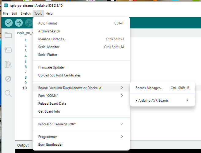

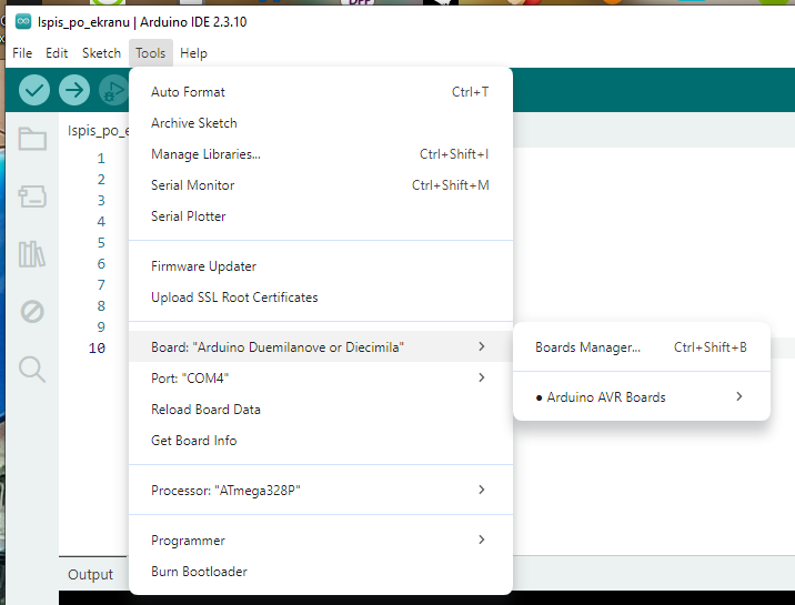

Koji IDE bih trebao instalirati? Verziju 1.8.19 ili 2.3.10? Imam Windows 10 na računalu.
Hi @hrvoje_penavin
You should have no problems using the latest (2.3.10) version.
The image shows the settings in the Arduino IDE (Integrated Development Environment). The old Croduino works flawlessly with these settings. Now that I am sure the Croduino is working properly, I can move on to the “real” work. I will post an update when I have something new to share.

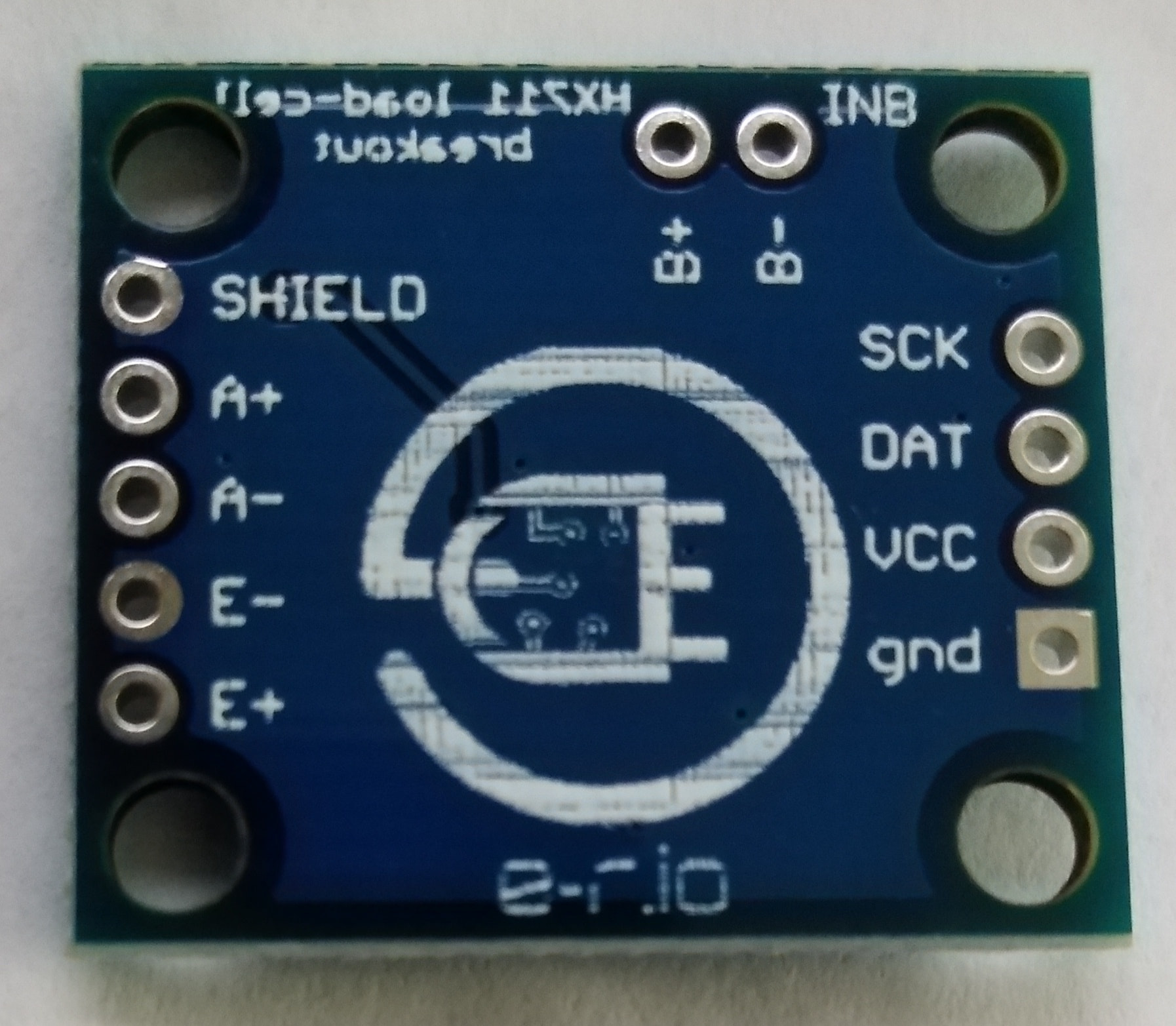

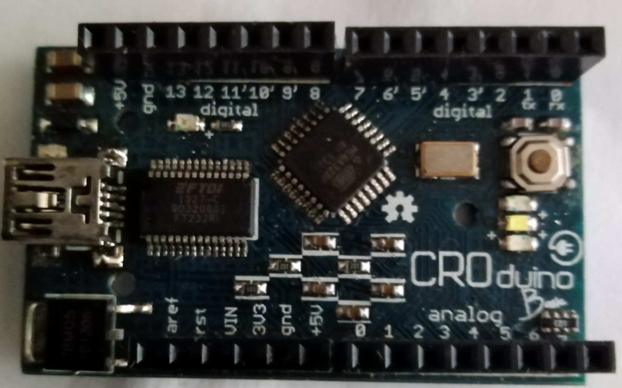

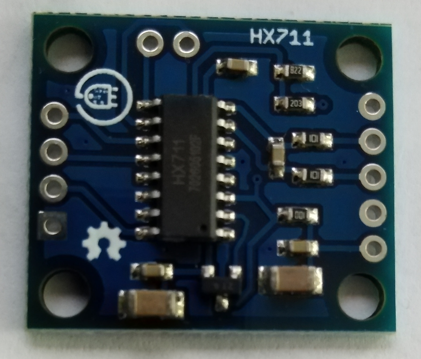

The components I have available.
